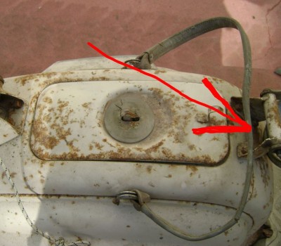

3. Is there on the engine cover a holder to hold the cover (maybe someone has a photo so I can rebuild this)?

With th holder i mean a stick that holds the cover in " up-position" to work on the engine maybe..

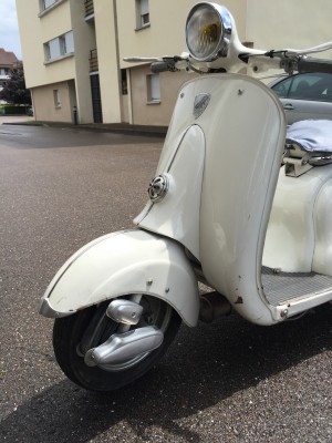

Concerning S557 you won't receive an answer from Peugeot museum since it is not a Peugeot. Send us a picture of your scooter so that we can identify what is it.

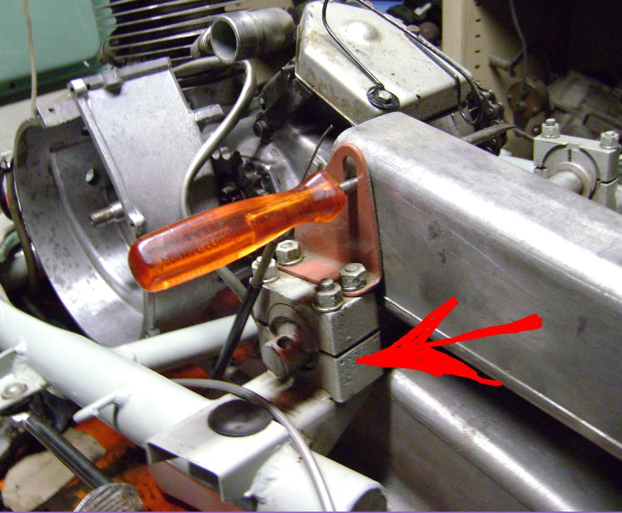

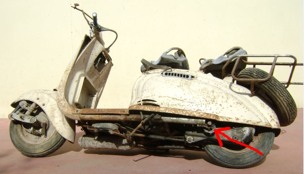

To maintien the cover in up-position, use the strap, which you can stretch out at the hook : See the attached photos

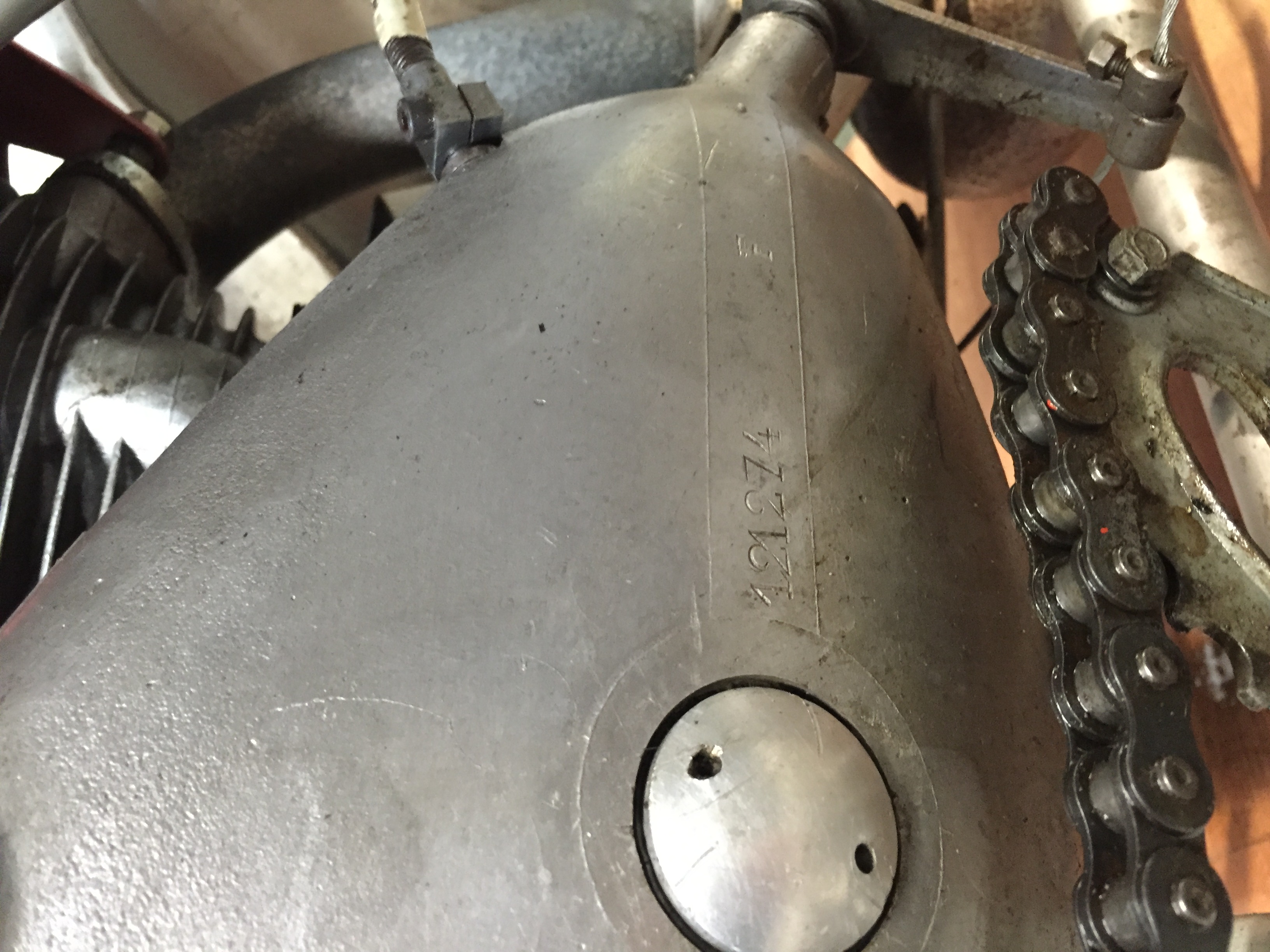

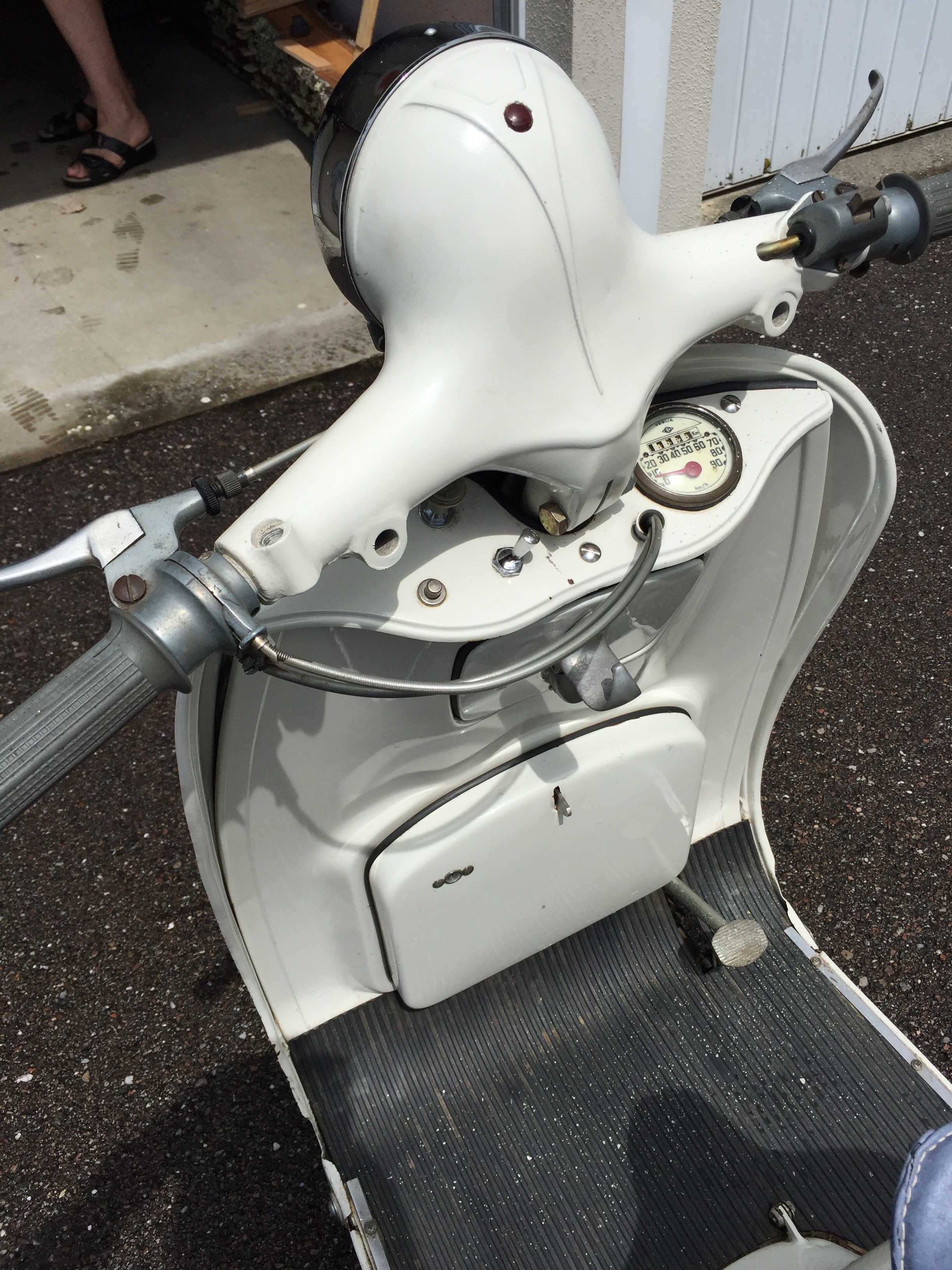

As far as I can see on your pictures, your scooter is a Peugeot S57C.
The type and the serial number are carved on the steel frame (see attached), in the glove compartment/the toolbox. Is the same thing written everywhere ?
The guy who made the manufacturer's data plate may have made a mistake and he may have replaced 5 by S ?

Re: Many Questions
I think there is something wrong...
The number of the steel frame and engine is the same, but in the toolbox is an other type and number?!

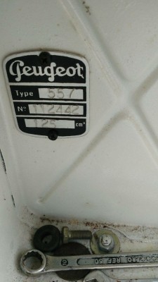

Re: Many Questions
you'll have to change the manufacturer's data plate !
112442 is not compatible with S57C

can you tell me if my plate is original? (see picture above)
Re: Many Questions
yes it is, on the new one you'll must write type " s57c" number " 121274", 125 cm3 and it will be ok.
