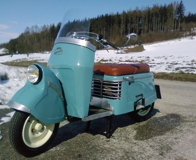

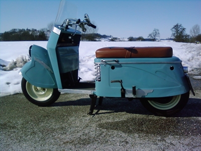

Hello !

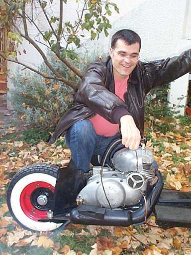

Now i almost finished the restoration of my Berni C50 !
Some Parts are not original ( Tank is selfmade and Exhaust is from a D51 )
A Steeringlook and a Jaeger clock i found on the Market in Reimes
Today i have the maiden drive - cool feeling !
But i have a Problem - the Engine become very very hot - and after 10 min. of driving the Engine goes out .
After some minutes to cool down it starts immediatly .
It is no Problem of Ignition .
Ignition Time is 23° or 4mm and the Carb is a 18 Dellorto
Have anyone of you a idea why the engine became so hot ???
THX for help

Re: Problem with my Bernardet C50
WELCOME !!!
Very nice your Bernie !
the same model as mine !
Have you got the goods sparks ? I use Bosch W5AC, but Champion L45C are good too.
Does your "condensateur" (I don't know how translate...) are OK ?
Hello !
nice too , your Berni !
Yes i use a W5AC Spark Plug .
And the Condensateur is OK - because i don´t loose the Spark .
The carb become to hot - the Benzin in the Carb start to cooking ......
Is it Ok that the Fan ( Ventilation ) don´t blow - it work like Airsuck .
What do you mean ? Who many C 50 still exist ?

Did you rebuilt the ydral engine by yourself ?
noplastik
Yes ..
with New Bearing , Piston and clutch and it start on the first Kick .
The Gear work good and easy .
a other problem is the light - it is very low .
Is the carburator main jet the good one ?
Some machine needs a special main jet during the "rodage" .

hi paolo,
i think that your problems come with two directions .
first one and unchangeable, is that you ride a vintage french scooter !! so the cooling system is not at its best ....
the second possibility, is " vapor lock'" , cause by the heat of cylinder head, moving threw the pipe to the carb .
one solution is to create a small pad ( 0.8 to 1.5 mm thick ) in neutral material as celloron, asbestos (amiante ..oups i don't said it!) to cut the heat transfert between cylinder and carb . you can install too, a small aluminium sheet deflector ,on pipe's studs to move the heat flow away from carb ...
we would be happy to see you and your C50 in Lyon ,the 24-25 of april , for the Club Ydral France 20 th anniversary show !
see more infos on www.club-ydral.net
the Main Jet is now a 82 . ( what is usual with the 18 Dellorto )
The aluminium sheet deflector is a good idea - even the "Thermo Spacer" between the Cylinder and the Carb
My Berni run between 70 and 75 Km/h ( and i have 120kg ! )
I was really surprised from the " Power "
But the scooter is very loud
lot of Questions - i know , but after 2 Jears of search i found out that your Forum ist the best help !
In the case of the 20th anniversary show from Club Ydral , i´m sorry it is a little bit to far
The Trip to Reims befor 2 Weeks was already " heavy " - 2000 km for only one Steeringlook ( i´m crazy ??? )

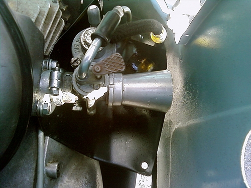

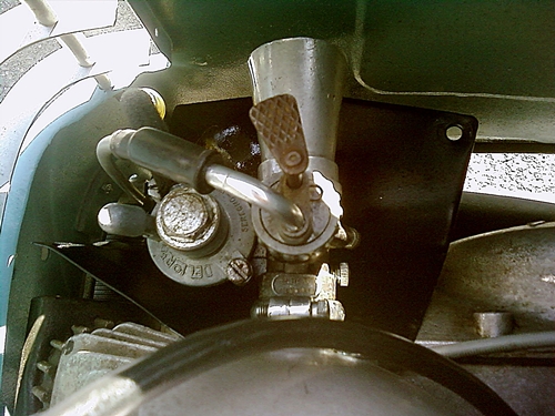

Problem resolved !
Now it works - and the Engine/ Carb don´t get hot anymore .
3mm Gasket between Zylinder and Carb and a deflektor shied ( not professionel ) bring the result .
berni drive now fantastic !
Thx to all for help !

Not realy - mine look a litle different - during the next Days i will make some Piktures of it .
Thank you " Jean-do " for the Pic´s from your Exhaust .
@chaud devant - i´m from Austria and there are only 2 Berni`s - one in Vienna in a Museum and one is mine !
I agree 100% - it is a cool scooter - today i drove 14 KM .
The people in Town did look like i´m naked on scooter
The carb which i test on my Berni is a MA18B - it look like a Carb from a " Vespa VB1 150 or VL 150 "
